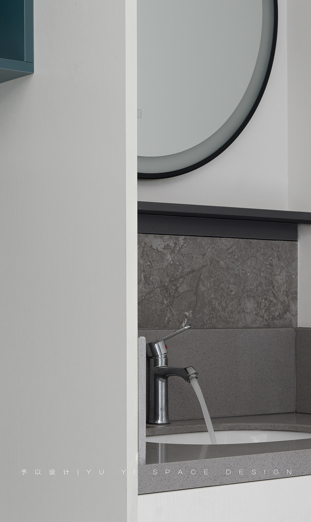

客厅电视墙设计柜体与洗漱台的结合,功能叠加,辅助客厅收纳的同时,实现干湿分离。右侧门后是卫生间,因为原始面积原因,本身空间局促。通过分析需求和对空间的重新整合,将洗漱台与电视墙作为一个整体设计,在解决使用需求的同时,将其融入到客厅的整体氛围中。
Sitting room TV wall design cabinet body and wash gargle table union, function superposition, assist sitting room to receive while, realize dry wet separation. Right after the door is toilet, because original area reason, itself space is cramped. Through the analysis of the demand and the re-integration of the space, the wash gargle and TV wall as a whole design, in order to solve the use of demand at the same time, will be integrated into the overall atmosphere of the living room.

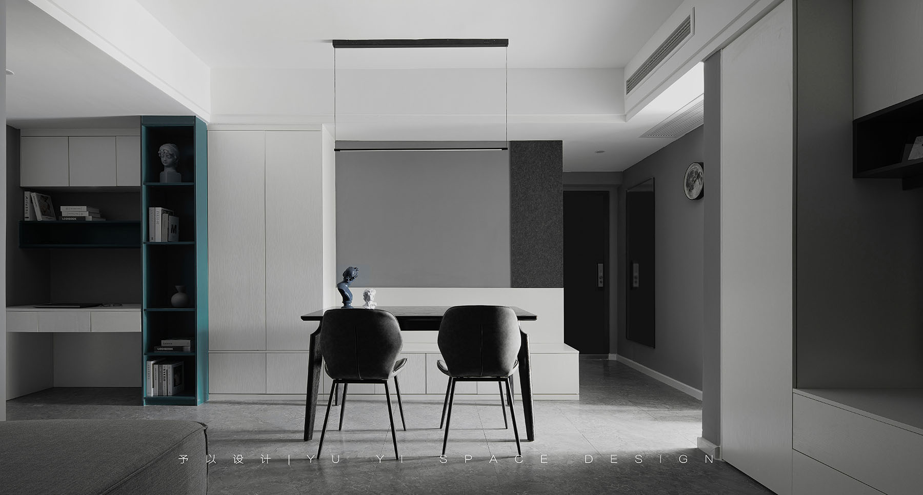

推开入户门,端口增加端景玄关墙,增加归家仪式感。左侧墙面强弱电箱前挂穿衣镜面实用的同时,入户宽度得到延伸。右侧设计鞋柜储物区,柜子转角与餐厅卡座顺势结合,在形式上让空间更具流动连贯性。餐厅卡座与储物柜、书柜、书桌的构成与结合,更使空间体块得到延展,储物功能与使用功能得到强化。
Open the door, the port to increase the end view porch wall, increase the sense of home ceremony. Left metope strong and weak electric box before hanging dressing mirror practical at the same time, into the width of the extended. Right side designs shoe ark to store content area, cabinet corner and dining-room booth take advantage of a trend union, let a space have flow coherently in formal. Dining-room booth and store content ark, bookcase, the composition of desk and union, more make dimensional volume gets extend, store content function and use function get aggrandizment.

    两大功能硬伤
    1.冰箱离厨房太远,每次洗菜拿东西,穿过整个客厅... ...
    2.卫生间面盆外置,还是跟电视墙一面墙,真的容易乱,也给人膈应的感觉;
    如果电视墙沙发墙对调,冰箱靠厨房放,和电视墙结合一体,这样冰箱离厨房更近,冰箱外置总比洗手盆外的来的方便和美观;
    洗手盆完全还可以放在卫生间里面,前提房主愿意的情况下,在美观和功能做取舍,住宅来说,功能至上,拙见!
    正解!在洗手盘洗脸真的会溅水 到时候淌得满地都是 而且还是在客厅 。另外一个问题就是 关上卫生间门和厨房门 客厅居然没有采光?
